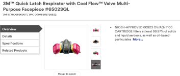

Nay say I! Wait for the warm dry day, rattle that can but don't paint in the sunshine, or your paint will bubble. So: Hot, Dry, No direct sunshine, Plenty of ventillation, Windless day AND wear a proper respirator. Paint fumes FRY BRAIN CELLS, you don't want ANY of that stuff in your lungs/brain.
This is what I use:

But, and I mainly have experience with lacquers (solvent based, not water borne), @RetiredUnit1 is correct in his caution. You need some sort of active filtration (basically a small booth with an exterior vent) if you want to spray paint indoors. Even with waterborne, low VOC, and a good organic vapor mask, it’s dangerous.

I use a standard air compressor that I picked up from harbor frieght that also powers my impact and air nailers for the wood working i do and use a set down valve to get the air flow dialed in. Using a Iwata Eclipse HP-CS and spraying around 25 psi, with a respirator (like the one @RetiredUnit1 showed) I will blast varies acrylics and enamels onto the primed enclosures aiming towards a small fan that is on high that blows into furnace filters. This collects about 75% of the excess and minimizes the smell of enamels. I allow the painted enclosures a day or so to dry and then will use a clear coat depending on the paint used and effect i am looking for. This varies between a rattle can for gloss enamel and flat acrylic to airbrushing an acrylic gloss type finish.
