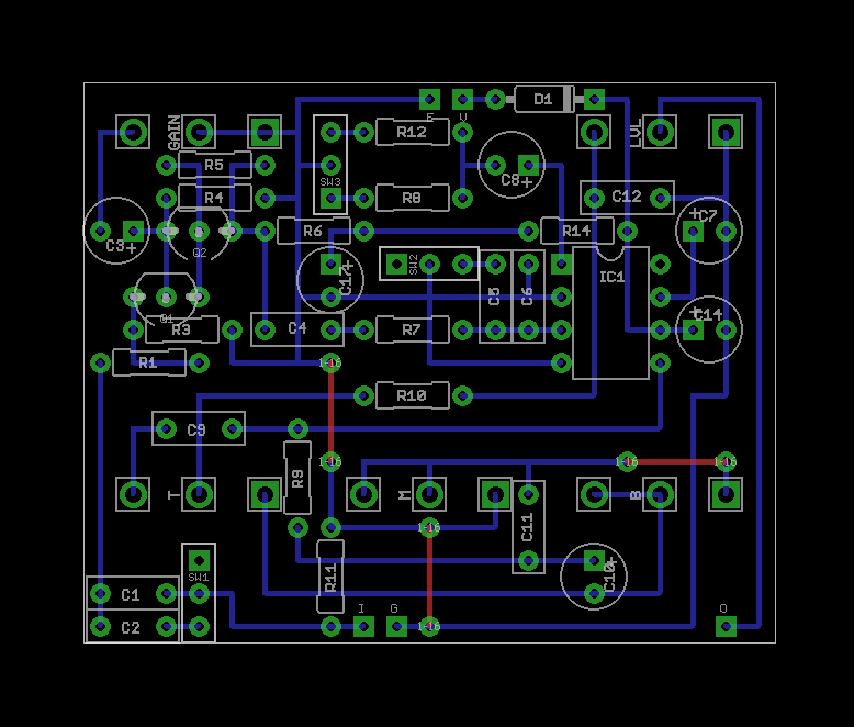

Here's my layout. Red X's represent cuts. IC1-8 is not connected on the board, but is connected inside the IC. That's why there is a cut under that pin. Use my board pic (above) as an assembly guide. R2 & C16 aren't used. R13 & C15 are for the Magic Eye LEDs: a back-to-back pair of red super-brights with the other end connected to ground. You can omit R13 & C15 if you don't hook up those two LEDs. GND is 2 columns wide above IC1; bend one of the leads on C6 over on the solder side to bridge the two columns. Polarized caps have the line at the - side. C7 & C17 are a snug fit, mine kinda sit on top of the parts next to them. C14 can be 100uF or larger; I ended up using 220uF. Size Rled for the desired brightness. Q1 can be any JFET with Vp around -1V; pinout is D-S-G. Pots and offboard wiring are per the schematic. There are five GROUND connections, use as many as you like.

Yes, you can use the same values for Marshall TMB. I encourage you to use Duncan's Tone Stack Calculator to see the effect of changing component values and the difference between Fender & Marshall.
