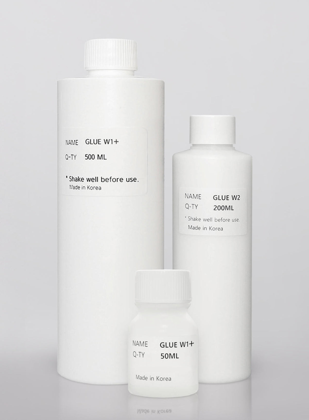

What type of costs am I looking at to buy enough of the sheet, glue and A1 stuff to do about 20 pedals worth? I can squeeze 4 per sheet so can I buy 5 sheets and enough glue and A1 steak sauce or do I have to buy in much bigger bulk? Anyone willing to sell me part of their stash so I can try this method? I have a garbage color inkjet and i have a decent black laser printer. I see this stuff only works with laser.

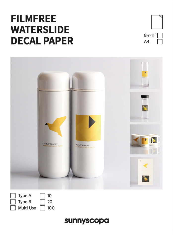

You can fit 6 125bs on a sheet. It's a little expensive but for me it's the only at home graphics solution I've been happy with
So, buy 20 sheets for $17.80
Buy 200ml of W1+ Glue for $15.00
Shipping is $14.00. So All in for $37.90 not bad AT ALL.
Curiously, they have a TON of different types... The film free, laser waterslide, film free metallic, inkjet waterslide, etc etc etc.. Without question, tested, the #1 way to go is the "FILMFREE WATERSLIDE DECAL PAPER" ?
That's the stuff. I believe that @Harry Klippton has used the metallic stuff before.

Interestingly, it was works out to $0.89 per sheet if you buy 10 or 20 sheets, $1.25 per sheet if you buy 50 sheets, and $1.06 per sheet if you buy 100 sheets. Pretty significant savings to just buy multiple 10 or 20 packs over the larger packs.
