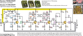

I'm trying to wrap my head around this schematic.... particularly the LED / bypass wiring.
The way this is drawn the LED would be lit (and brightness controlled by the volume pot) when the effect is in bypass.
Am I missing something? I'm assuming the throw is drawn on the wrong node, and should actually be on the point that goes to ground.
Looks wrong to me as well. It doesn’t make sense to have to LED go to output in bypass. Definitely think the node should be on the ground point.
EDIT: Is it wired like that on all of the Kit Rae schematics?
  • Like
Reactions: fig
the LED switch in that schematic is incorrect. In bypass the LED goes to effect out and doesn't reach ground to complete the circuit ... also I don't believe they ground the circuit input while in bypass.
