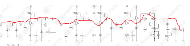

Set the drain voltage of Q1 to Q4 to half the supply voltage. Q5 - Drain sould be around supply voltage (slightly lower), source - probably around 5-6V. Then inject some signal and start checking with the audio probe from the input.
This is the signal path

@temol This diagram is helpful (I think I understand your outline and recommended drains). I might have some questions on this though.
