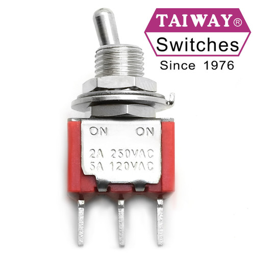

For reference this is the switch I used in the build;

First thing I’d do is check to make sure there’s only continuity between the middle and top lug of the switch when it’s in the down position, and the middle and bottom lug when it’s in the up position. If the switch is busted there’s a chance the mechanism is stuck in one position (or shorting between both sides of the switch) regardless of the switch position.

Interesting you say that, when I first flipped the switch I heard a POP noise come from my amp which, in my ignorant opinion, could possibly mean something shorted/busted in the switch. Does that kind of thinking make any sense?

I opened this piece of crap back open and I replaced the SPDT switch with another one thinking it might have been busted. While I had the pedal gutted I decided to take fig's suggestion and replace C7 with a 22nf capacitor. I get it all back together and the toggle switch still isn't doing jack. SOMETIMES I can hear a little tiny itsy bitsy pop but 99% of the time when I am listening there is zero diserable difference in the tone. There is no way two switches in a row could be busted, right??

EDIT: One more thing to note; when i installed the switch i forgot to install the metal washer between the enclosure and the switch itself. Since it's a metal washer I don't think that should be shorting anything but I have no clue at this point and I don't want to leave any details out.
