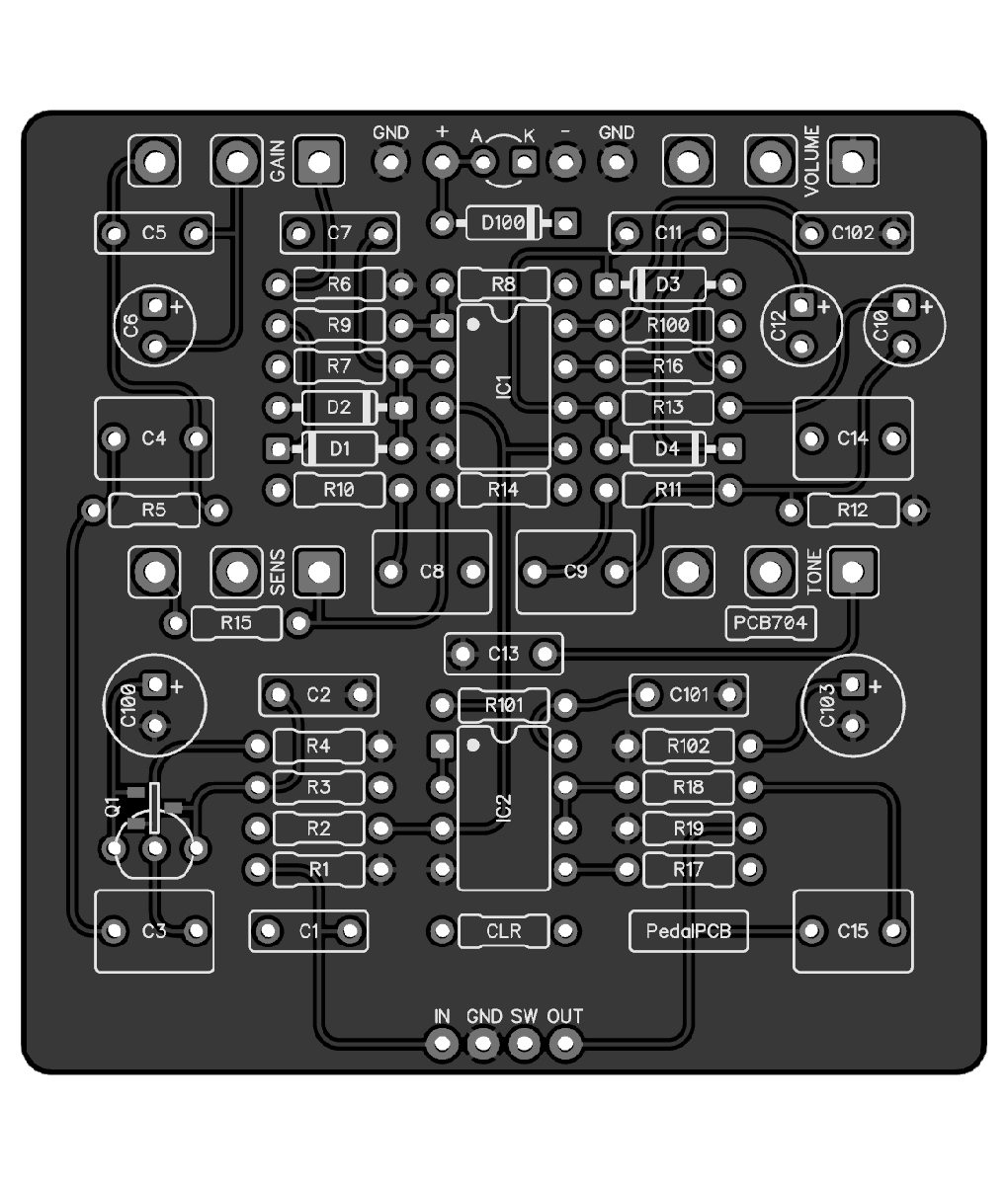

then i had an idea.
there was a decent amount of space left on the breadboard and so i thought,
what if i put the MT-2 EQ after a different distortion circuit?
how about a RAT? that’ll be quick.
so i pulled out an LM308HZ and plonked in a rat circuit minus the filter etc. and route it straight from the diodes into the MT-2 EQ (via 10uF coupling cap in between)
still sounds a lot like a rat.
worked well. EQ does the thing.
then i did the same thing with a big muff V2
[Q3 collector -> 10uF -> MT-2 EQ (at R28)]
just grabbed x3 2N3904 and went with a 1973 #4 schematic that i already had downloaded on a tablet.
result?
very much retained a strong big muff character.
for me, this experiment kinda flattened the whole ‘big muff sound is all in the tone circuit’ argument that i’ve seen around 😏
no matter what i did, that big burly fat muff distortion fuzz is all there, inescapable, and sorta kinda limits what the MT-2 EQ can really offer, but regardless this was surprusingly good and made for an interesting muff.
unfortunately i had the bass control up way higher than i’d like it to be for the demo (got lost in the bass, my bad)
^this also highlights why the the treble, bass, and middle pots all need to be W taper.
i used B taper and it makes fine control at the higher / lower extremes a lot more sensitive/difficult to dial in.
