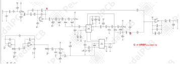

Thanks! It sounds great, best chorus I've had in a while! Wish it was stereo!
if you're good with translating vero layouts with schematics etc. - you could build a daughterboard, run a few jumpers, and it can be done.
if you can find on your PCB where points A, B, and C are (per the attached annotated schematic), and can build the 13x8 vero daughterboard, you can have a stereo chorus.
i can't actually verify this stereo mod myself, i haven't done it, but it appears others have:
View attachment 40498 View attachment 40499
Whoa! This I have to try!
I think I have everything to build this daughter board. I might just do it and connect it with alligator clips as a proof of concept, then design a new box. Looking into it, the stereo bypass seems to be a bigger PITA than the daughter board!
