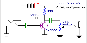

If you're new to breadboarding I would highly suggest this nice little circuit block. It is probably the lowest part count fuzz that I can think of using very common components. Popularized by Runoffgroove, it uses 1 transistor, 1 resistor, a diode, and 2 coupling capacitors. You can read more about this little ditty here.
Let's take a look at the schematic.
Now, my breadboard doesn't 100% match...
