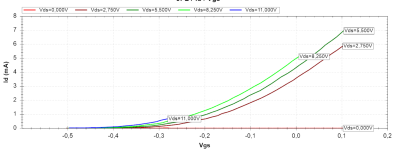

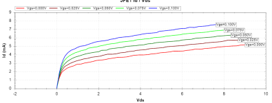

music6000
I don't know, I have them in a case from a long time
I have a peak DCA75
Hook any 3 leads on to the transistor legs & TEST for confirmation if it is a Legit 2N5458 ????
