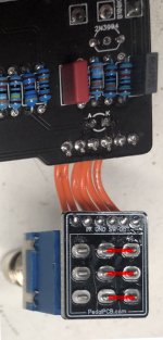

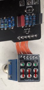

I drew this up while Mcknib was answering so,
1. Check for Continuity on the 3 individually marked in Red, This is Bypass / Off mode.
2 You should not have continuity with the Red Centre pad & Green pad directly above it while in Bypass/ Off mode.
This applies to all 3 footswitches !
As Mcknib stated: remove either your Input jack tip or sleeve wire at the jack end and see if they still have continuity that'll tell you whether it's the jack itself or something else like a solder bridge
Maybe Solder has fallen inside the Jack & caused a Bridge/ Short.

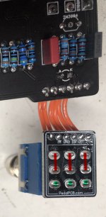

As Mcknib just answered I was busy again so, When Switched to ON position, Check for Continuity on positions marked in Red.
Make sure you don't have a bridge or Continuity to Footswitch bottom pads in Green.
