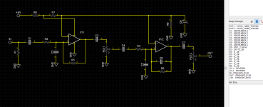

Here's the schematic:
Here's my Diptrace version:

Cool, I've been curious to try this myself sometime.
Looks like you need a pad for your ground wire to come in.
Yep. I haven't added any ground pads yet. I want to learn how to do a proper ground plane so I'm kinda waiting on some advice.

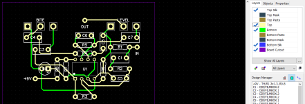

OK. I tried doing a different layout that would at least put the in, out, and power in a reasonable spot. All the verifications pass. Please give me some critique on how to layout this better. Grounds again are highlighted red for reference.

It's a personal thing and not at all necessary, but I put all my in/out pads on 2.54mm pitch so that they line up with PedalPCB breakout boards and quick connects can be used by those who like them.

If you have a copper pour as a ground plane on both sides of the board, you won't need any of the ground traces. Makes it simpler.
You don't appear to have a pad for your LED cathode to connect to ground via your foot switch. That may not be required for this circuit, I don't know what your intentions are.

Good call on the LED ground pad. Although, I'm never sure where I'm gonna mount an LED so it's not terribly important. I don't mind not using a footswitch breakout board, although I could move the pads. Still playing with it. I haven't done the ground pour yet as I wanted some feedback on the traces and layout first.

I think the layout is good. There are a few traces that could be made shorter, such as R2>C2, which could connect at the elbow that leads to pad 2 on your IC.
Pad 6 on the IC to R4 could be made with one straight section and one angled section, rather than having two angled sections.
Your network of Pad 7 on the IC, C7, C6 and R5 could be made simpler, I'm assuming you've routed them according to the schematic there, but you can optimise the ratlines before routing to get shorter, simpler traces. R5 could be the central point that everything else connects to on that net.
There's a right angle in your trace coming out of the electrolytic capacitor which you can eliminate. 45 degree angles are better.
R1>C1 could be a simple diagonal.
You can also manipulate the point at which traces connect to pads and this can make the traces slightly more efficient.
I hope you take this as helpful rather than critical, you've done a good job and are absolutely on the right track. 😁
Here's how I would change couple things.
I would also try to stick to the grid when it comes to components placement. For example - R1 and R6 are a bit lower than pins 4 and 5 of the IC.
Ok. I took some of your suggestions and reqorked a few traces. Added a bototm and top ground plane as well.

Looks good @Blooze. All I would do differently is route C7 to R5 instead of C6 (shorter trace) and make a long 45° section on your trace from Level pot pin 2 to your Out pad to get rid of the right angle (and make a shorter trace).

The other thing I do is make the boards a rounded rectangle. They are a lot nicer in the hand and inside the enclosure (which is itself a rounded rectangle). It takes a bit of figuring out to begin with but it's really simple once you work out the required differences between points and the arc size. I always go for a 2mm arc.
There's still some room for improvement
Trace between LEVEL and OUT - does not have to be so close to the edge. If you rereoute it then you can close the pour around the board edge.
Remove copper islands (marked by violet color). If you move trace betwee R7 and R8 a little bit to the right then you fix one island.
There's an option in the copper pour properties for island removal, which will remove any disconnected copper islands from your board.
