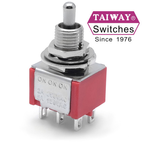

This sounds like an issue with the toggle switch, where did you get your switch (and what part number)?

Well, @PedalPCB, regarding the toggle, this is actually the second time I’ve been through the on-on-on switch issue on this forum. See this thread...
https://forum.pedalpcb.com/threads/can-someone-demystify-“type-1”-versus-“type-2”-dpdt-switches-for-me.5385/#post-44619
...and as a result of
@music6000 ’s recommend, I went with THIS little guy...
so I feel like I should be solid with that...you tell me.

That should be the correct switch, but something isn't quite right.
The red LEDs should only be active when the switch is up. They should be out of circuit in the middle and lower positions.
If you wired the toggle switch offboard I'd definitely double check the wiring.

Yeah I was wondering that myself—you are correct about the offboard thing. That is allowing me to mount this sucker in a 2RU housing with other pedals which you’ve probably devined from my other build posts.
But the six little cable extendo wires are definitely “apples-to-apples”...no crossed wires here.
