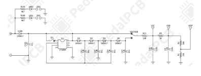

Here are the schematics. I'm not sure of where to start and what path to take.
Do I start at D100 ? If so, I lose signal right away
Edit : Or more probably I should start at R12 and C1. It doesn't make much of a change. Apart from the tips of the jacks, I can't seem to get audio anywhere. 🤔

D100 is going to be the protection diode. Since the power seems to be working but the audio isn't, you'll want to trace the audio path starting at [IN] - R12 and check the nodes along that path. When it splits, first try where it joins again. If the signal is still good, keep moving towards OUT. If not, let us know the point closest to the OUT you were able to find a signal.
Someone else may have a better method, but I've found most signal problems in this manner.

I think I was editing my message while you were writing yours. I figured I probably would have to start at R12. But I can’t even get audio there
