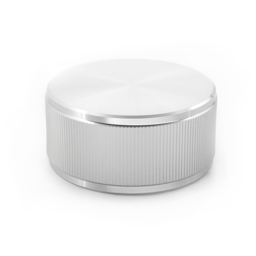

I think I'll add the volume back using a tiny knob for the "oil fill cap"....sweet!
