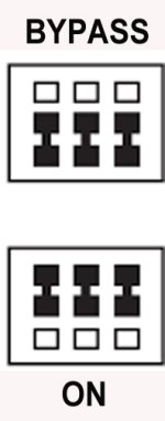

Once I fixed the polarity on the DC power I get sound. I am now trying to debug why the rotary switch isn't working.Check your Footswitch for Continuity to make sure you have no bridges between pins up & down.
You should not have any Continuity from left to right on middle pins:
