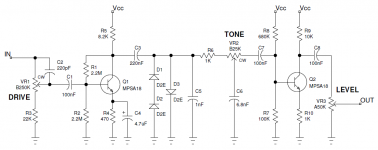

At the moment, I'm leaning toward a Crystal Drive with D9B's in place of the BAT48's.

Can you tell us a circuit where you are satisfied with the tone control? :LOL: I imagine that if I knew what you know I wouldn't ever be satisfied.
(edit) Just looked at the schematic and can see why you're not impressed. I might have a look at building that one - do you think the BAT48s are an essential part of the sound or is that why you went with Ge?
LoL. Here's what I built (so far). I didn't want it to load the pickups, so I rescaled VR1, C2 & R3. It still loads the pickups when DRIVE is dimed, but is better behaved at lower DRIVE settings. Clipping diodes were changed from Schottky to Germanium for softer clipping. C5 did nothing at 100pF. 1nF shaves of a tiny bit of the top end. The TONE pot used to changed the volume and tone when turned, now it only changes the tone. I might increase C6 some more, undecided at the moment. Scaled up R7 & R8 so they don't load the tone network as much. Seemed a bit silly to me to use a high-gain transistor for Q2 and then make R7 & R8 so small, so I scaled them up and biased Q2 a little hotter.
Q1 and the diodes make all of the distortion and are responsible for the sound, so yes, Ge and Schottky will sound different.
Update: I corrected the diode part number on the schematic.
