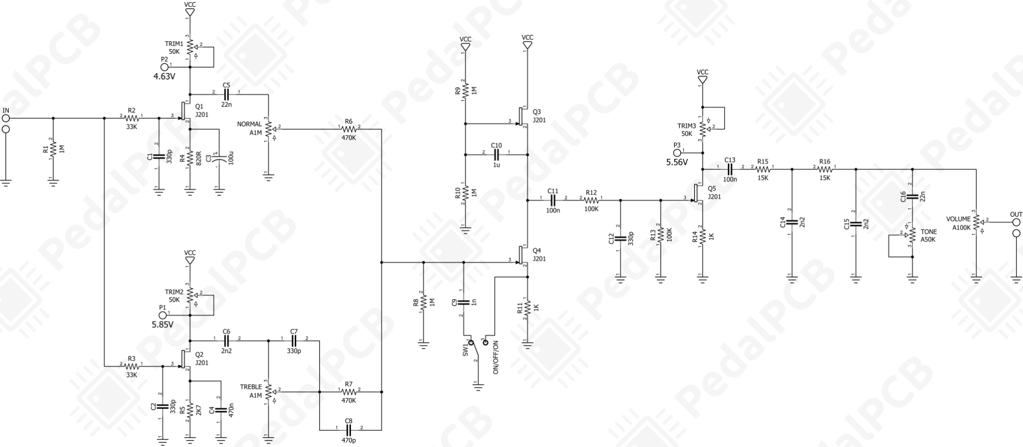

Two weeks ago I never heard of this pedal. But it's been recommended by so many different people since then that I just had to build it.

For those unfamiliar with it, it's a transistor clipping Marshall-in-a-box type pedal that has 3 different flavors on a toggle that map to a 1987 JCM style, 1959 Plexi and a JTM.
Do they sound like any of those amps? Uhm.....well....no, not really. But the 3 modes DO sound fantastic. The controls are not real intuitive and I'm still figuring them out but there's a whole range of low to high gain sounds in there. I was comparing it side by side with my XS Drive (Xotic Super Lead), Van Pelt (JHS Charlie Brown).

The original pedal uses ceramic disc capacitors. Of which I have none....heh. But I was able to populate most of the ceramic pads with MLCC caps.
I really have no idea if it would sound any different with box film caps or cheap ceramics but if the designer of the pedal went with ceramics then there must be a reason. I'm toying with the idea of building another one with the disc ceramics just to see if it makes a diff.

I also used SMD MMBFJ201's. Man those things are tiny, but I think I'm getting the hang of soldering those little suckers in. The real trick is in how to pick them up with pair of tweezers. They have a life of their own and are like Mexican jumping beans.......squeeze a little too hard and they'll go flying. And they would be impossible for me to find on my garage floor!
I biased the transistors to the specs that are silkscreened on the board. Very handy! Sounds great with those settings and I probably won't bother messing with it any further.

Don't think of the Normal/Treble controls as EQ controls, they're volume controls for two parallel channels.
I've recently seen another Colombo pedal which also uses ceramics throughout, so I'm thinking that's just "his thing" and not necessarily selected specifically for the Plexi Breed circuit.

Ok that's what's confusing, so should treat it like an "always jumpered" 4 hole plexi? Then dial gain 1 and gain 2 to taste?
Yep, that's basically it.
One is voiced brighter than the other and they blend before going into the "power" section.
The Tone control rolls off highs right before the Master Volume control.
Ok I get it now, I see how it works. That makes a lot more sense!
He should have just called it Gain 1 and Gain 2, much more familiar to Marshall players.

I use the Normal Gain knob as a Bass style knob at around 9.00 O'clock, 7.00 O'clock being full CCW.
The Treble Gain knob is the one I use for how much Gain I want the pedal to have.
When I have it where it's to my liking, I will turn the Normal Gain Knob up or down to the amount of Bass content I want.
Then adjust the Treble Gain pot to fine tune.

My apologies if I added some confusion. I was just making a little joke about how the ramble marvel drive and the colombo plexi breed have almost identical schematics except for the switch and the 18 volts from a charge pump.
