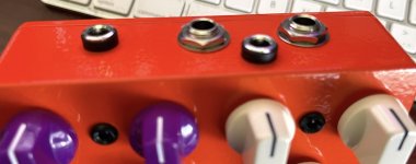

Anyway, since I already drilled the enclosure I was determined to make it all work, so there was a lot of creative bending, switch modifications, and strategic shrink tube insulating. Not to mention quite a few bent capacitors to make it all fit into a 1590BB. There was also a face palm "whoopsie" for where I originally located the DC jack (see pics below). But in the end it all works! Not my most elegant build, but as they say, once the back cover is screwed on, who's gonna know right?

I don't know wtf I was thinking when I drilled the DC jack hole there (blue arrow) Obviously would not work, so I had to relocate that. I stuck a clipped dummy DC jack in just to plug the hole. Duh......
