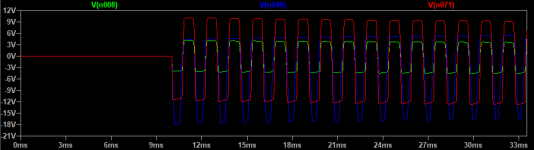

But there's more. Sinewave @ Q1. Green - 9V supply, blue - 24V, no R adjustment, red - 24V, R adjusted.

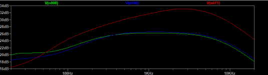

Seems ok, right? But then there's first stage frequency response - not so right.
Colors as above
It would be necessary to recalculate each stage in order to keep frequency response similar.
