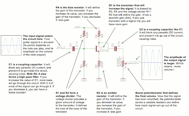

Just got your breadboard or protoboard in the mail and don't know where to begin? The Test Kitchen's got your back! Let's start with a classic and simple circuit: the LPB-1. This is a simple booster and a basic building block for many circuits out there. Here is a schematic taken from Coda Effects.

Let's set up our basics first: guitar input (I used an orange jumper wire), power (+ is red jumper and - is black jumper), the input capacitor C1, and a 2n5088 NPN transistor. Notice the transistor's flat side is facing left in the picture. The pinout for this as read from top to bottom is Emitter (E), Base (B), Collector (C). If you don't have a 2n5088 lying around try another NPN transistor such as a 2n3904 or similar. Just check to make sure the pinouts go this way and if not, simply rotate the transistor 180 degrees.
Next we need to add R1 and R2 and then connect that to the Base pin of our transistor. The schematic calls for 430k ohm and 43k ohm transistors, but I chose to use 1m and 100k for 2 reasons. First, I had these values lying around on my workstation and decided to be lazy . Secondly, the relationship between R1 and R2 matters more than anything else: R1 is 10 times the value of R2 so you can use nearly any values (just keep r1 pretty high) as long as the relationship stays.
R1 goes from power to the same row as the capacitor and R2 goes from that same row to ground. The result? This is a voltage divider and the "new" voltage created is approx 1/10 of the input. In this case about 0.9v. Yours may differ slightly due to the tolerances of each resistor, but it should be pretty close.
From the row with the 2 resistors and capacitor we jumper this to the base pin. Why do we need to add power to the base? It is called "biasing" a transistor. The transistor needs DC power in order to operate and your guitar signal is AC. So, we add both at the same time to "trick" the transistor into working.
OK. 3 more components and we are done with the basic circuit. Let's add R3, R4, and C2.
R3 (390ohms) goes into the row with the emitter (remember, that's the top pin mentioned above) and out to ground. This resistor controls the amount of gain in the circuit. 390 ohms tends to be the sweet spot here, but you can alter it to you liking. Anything above 1k doesn't really work but you can give it a go.
R4 (10k) goes into the row with the collector (bottom pin) and the other end to power (red strip). The body of the resistor is kinda blocking the picture below but trust me on this one.
C2 goes into the same row as the collector and down a few rows. From here you can add your "Boost" potentiometer (it's just a volume pot going to ground) or you can test your circuit by merely adding an output jumper wire. I chose a white one. Be careful: since it's a boost circuit it will get loud!!
If you're looking at the potentiometer with the knob sticking up, the pinout is 1-2-3. 1 goes to ground, 2 goes to your output jack or plug, and 3 goes to the end of C2, right where my white jumper cable is.
I don't have a picture of the Boost pot wired up since I will talk about mods below and you'll see why I skipped this step.
And that's it. The LPB-1!!
