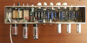

Well like pedals, I build my own. In fact I only got into pedals when I couldn't afford to keep building amps.
Here is the interior of a '68 50W plexi clone I built a few years ago, since sold. It sounded incredible but was sooooo loud! As I tend to build them into smallish combos I used bigger PI caps than standard.

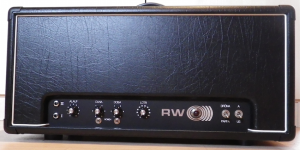

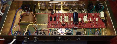

Based on a Fender, Fullerton 22w Toroidal by Darryl Hoy @ VALVETONE, Cabinet by EB Amps.
2 - 6L6GC, 2 - 12AX7.
Toggle switch for Gain, None & Mid Boost
Toggle for Bright
Toggle for Deep
2 way passive Footswitch for Mid Boost, Gain or Both
Meticulously Handwired Tagboard Design!
Built in Hammond Enclosure. 8 & 16 ohm.
Simple & Awesome!!!
