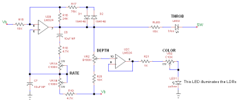

In part I, I discussed triangle wave LFOs. This time around we'll talk about sinewave LFOs. Sinewave LFOs show up mainly in Uni-Vibe type pedals, a few tremolo pedals and amplifier tremolo circuits. All of the ones I've seen are based on the classic phase-shift oscillator. To get a sinewave, we need exactly 360° phase shift at one frequency and exactly unity gain thru the amplifier and feedback loop at that frequency. If the gain is lower than unity, the oscillations will decay to zero. If the gain is higher, the oscillations will get larger and larger until clipping occurs. It's a delicate balance and it explains why sometimes a sinewave oscillator won't start up.
Below is the Uni-Vibe LFO. Q11 & Q12 are configured as a Darlington pair and provide the gain. C19-C21, R40-R44 and the dual C100K pot provide the phase shift. At one freq, the LFO's operating freq, the phase shift from the three R-C pairs adds up to 360°. Varying the resistance of the two pots changes the frequency where 360° phase shift occurs. The diodes provide soft clipping to limit the gain. The output is taken from Q12's emitter.
Sinewave LFOs gets kick-started when the power comes on and the sinewaves build gradually over several cycles and eventually stabilize. The designer of the original Uni-Vibe, Fumio Mieda, was a clever guy and put the diodes in a place where their clipping threshold varied with frequency. That way, the sinewave amplitude is small at low frequencies and gets larger at high frequencies. This helps compensate for the slow response of the light bulb used to illuminate the LDRs. Making C20 larger lessens the variable amplitude effect.

Awesome! What do you mean by "Making C20 larger lessens the variable amplitude effect." Will increasing it make the amplitude less strong, less obvious, slower? Asking for a friend... ;)
Chuck D. Bones
Allow me to clarify. When we turn the SPEED knob down the amplitude also drops. The amount of amplitude drop is less when C20 is larger. Increasing C20 only affects the amplitude at the bottom end of the SPEED knob.
zgrav
Since the univibe C20 paired well with the bulb due to the slower response of the lighting, does this suggest that C20 should be adjusted if an LED is used in the circuit instead of a bulb?
Chuck D. Bones

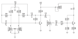

No matter how bigh you make C20, the amplitude will vary with RATE. If you want to drive an LED with a sinewave, then the Abyss LFO is a better choice. It's basically the same phase-shift oscillator circuit, except the amplitude is controlled by Q1 going into cutoff and saturation instead of diode limiting. With this circuit, the amplitude stays constant when RATE is varied.
There are also opamp-based sinewave LFOs, such this one from the Hollis EasyVibe. It's basically a triangle wave LFO followed by a diode clipper that turns the triangle wave into something close to a sinewave. It works pretty well and is capable of a huge frequency range. Moen copied the EasyVibe circuit for the Shaky Jimi.
