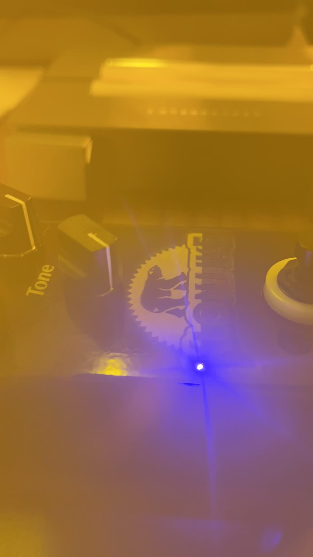

Hi all. I'm currently using either a vinyl cutter to cut stencils and spraying graphics, or no film waterslide for graphics. I like the idea of the precision a laser engraver gives me.
I'm looking at the Atomstack p9 M50 engraver. Its a 10w output and small footprint. So suits what I want to do.
Anyone with experience got tips or suggestions for using Lightburn. How easy is it to line up the graphics for a newbie? Don't want to waste a bunch of enclosures.

I went down the laser rabbit hole. Got a few different ones. Ended up using my Laserpecker 2 more than anything! Easiest laser to use. Its super fast and does a great job on pedals! Wish I would've bought that first, it would've saved me a fortune.

Interesting. Do you have to do the pedal in 2 parts? For a 1590bb pedal, it seems like the 4x4 inch engraving wouldn't be great. But I love the compact design.
What make it easier than others. Do they not all generally use Lightburn or lsrgrbl?
Laserpecker has its own app. Super easy. You can design anything you want. Save the image to your phone, then use laserpecker app to do the burn. WAY easier and faster than Lightburn. doing two parts on this is very easy. The laser will outline where you're working.
Heres one I did for Jared James Nichols.
Awesome work and thanks for the response. One last question. I see Laserpecker 2 and Laserpecker 2 pro. Do I need to get the pro or is the basic 2 ok?
I use Lightburn. Once you use it a couple times it’s pretty easy. Best way to line up your enclosure (without fiddling around by having the laser outline it) that I’ve found is to just export a thin outline trace and burn that into a piece of cardboard, then just plunk your enclosure down and good to go.
