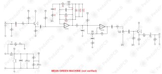

We'll wait for Buggs to release the official schematic, but I'm going thru the design, and I'm really amazed how close it is to just an ordinary TS9 with the 808-mod and 100R on R14 and 10k on R15 and all pots the same, etc.
What I was expecting was some changes to the clipping circuit...check, but possible changes to the B+ tightening things up and somehow tightening up the bass, at the same time lowering the frequencies for the lower tuning without getting muddy, but no, the B+ looks to be stock!
All that was really changed from the Little Green Scream Machine, is:
1. C1 on the input goes from 22nF to 47nF
2. C4 goes from 47nF to 100nF (funny, I use 220n and 470n)
3. R8 goes from 4k7 to 1k8 (again, I've used 1k5 and 2k2, so 1k8 is right in between)
4. R6 goes from 51k to 33k, again, I lower this
5. ok, this is where is differs...the 1N4148 clippers go to the 3mm LEDs, then pin 3 of the A500k pot gets disconnected from pin 1 of the micro and go thru a pair of opposing 1N4148s with a 220k in parallel....THAT'S IT!!!
It's amazing because, I don't think the pedal sounds anything like the original TS9, with 808 MOD, nor mine!! Funny, just a few changes make such a dramatic different!
Looking forward to the official schematic!
here, I marked up the original.

I made a LTSpice model based on your schematic compared a TS808, The text above each picture explains what you are seeing.
Stock TS808 gain sweep, tone at noon, volume cranked.
Your schematic gain sweep, tone at noon, volume cranked.
TS808 gain sweep, tone at noon, volume cranked. adjusted to fit in the scale of the other schematic for volume reference.
TS808 unadjusted for scale to show detail
I was curious though, I wasn't convinced the 4148 diodes were doing anything so I removed them.
It appears to mostly affect the minimum gain, and I'm not sure how audible the change would be, but it's interesting.

It's not so much about the gain as the tone. Hopefully I got the design/schematic correct (we'll see), but the pedal just sounds huge and tight. You get a little fir on the last last bit (9-10) on the drive knob, but again....tight and wide. I also A-B'ed it with one of my modded TS's where I like it. It's different. Mine still keeps the Vintage tone and characteristics, but the Mike's makes it like his amps and I think we all know how they sound! I'm thinking of including both my "Vintage" modded tube screamer and Mike's "Modern" on my pedalboard!
I can see things like the slightly larger input cap opening it up even more and making bigger. I can see adding the LEDs for slightly more gain and sizzle on the extreme end of the drive known. The thing that really I'm not understanding is what causing it to be soo much more "tighter" than a traditional TS9 or my modded unit giving it the more "Modern" tone?!?
R8 and C4 1.8k/100n set the low cut a bit higher than stock, 884hz vs the standard 720hz of the 4.7k/47n. Maybe larger input cap plus more low cut to compensate is what is doing it for you.

ive also built quite a few 808s and 808-adjacent circuits and tried various mods and such, like different R8/C4 combos etc., but when it comes to the NFB clipping diodes, this doesn't just affect the gain, clipping signal level, output etc., but the resulting tone is heavily affected.
we're all pretty familiar with what a symmetrical pair of silicon diodes sound like (914 / 4148) vs. asymmetrical which tend to sound more aggressive and 'bitey'..
comparatively, in my experience (with 808 circuits) subbing 3mm LEDs for silicon diodes (symmetrical pairs) results in a much brighter tone, and i would suspect this has a lot to do with the differing clipping behaviours, not just forward voltage.
eg.
previously, when i tried out a pair of 3mm green LEDs (~2.1v fwd voltage), the tone was significantly brighter and harsher than when i tried a pair of 3mm red LEDs (~1.8v).
could a nominal 0.3v difference in fwd voltage really cause such a dramatic change in tone?
whether this is due to a fwd voltage/brightness relationship or a whole other phenomenon of diode clipping behaviour that i don't quite understand, is beyond me.
have you tried a stock 808/TS9 circuit with a pair of 3mm LEDs (subbed for the silicon diodes) and compared it to this TS808-FM circuit?
i do wonder how different these would be, because what you're describing sounds very much like what i have experienced by subbing 3mm red LEDs into a stock 808 build..
