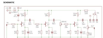

So some of you saw my first ever post and first PedalPbc build (VHS) in the build section the other day. This was my second successful build; my first build was with a board purchased from a competitor (who shall remain unnamed). Even though the build went well, I had some questions about the finished product; and so I did what most people would: went to their forum with my questions. Well, either their forum is dead or nobody wishes to help me, so since I received such a warm welcome from you guys the other day, I feel like I bring a few general beginner questions here and maybe get some help.
So this competitor’s circuit is meant to emulate
3 old fender amps of yore and simply has volume and drive controls. The drive packs a heck of a punch, as the description in the instructions state. But the description also says that it ranges “from a clean boost to overdrive”, however the thing is there’s nothing clean about even the lowest drive or volume settings on the one I built: it ranges from light dirt to pure filthy breakup. Don’t get me wrong, it’s pretty, but I wish it would start out as a clean boost as stated, and I’m wondering why it doesn’t. So my questions are 3:
1. The build contains 3 trim pots. Could how I set my trimmers have an affect on this issue? I know I installed them correctly, but I had no idea what to do regarding setting them afterword. I have never worked with trimmers before, so I just fooled around with the settings until I found the one I thought sounded the best.
2. Could switching transistors affect how clean/dirty it sounds? I used the 2N547 listed in the build instructions, but the instructions also suggested possibly experimenting with a J113, MPF102, or J201. How would switching the transistor up affect the sound?
3. And finally, could have I have done something wrong with the build to cause this?

Without knowing the circuit / seeing a schematic it's tough to say how you should set the trim pots.
In a lot of cases you start by adjusting the trim pots so the drain of each corresponding JFET (2N5457, J201, etc) measures a particular voltage, usually 1/2 VCC. (4.5V for a 9V pedal, 9V for an 18V pedal, etc)

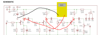

What transistors did you install? Where do you connect DMM?
I installed 3 2N5457s.
I was told to put one connector on the middle leg of the trimmer and then the other on one of the other legs, and then repeat to see if I get the seem reading with each, which I do, but I am checking ohms here not volts with this process…at least

“Ideally you want to bias the 2N5457s to between 4.5v and 6.5v using those trimmers and a multimeter. You’d power the pedal up and place the multimeter probe on the Drain of each 2N5457 the adjust the trimmer up or down until you get the correct value – the correct value depends on the 2n5457 (generally around 6.0v) and your taste (you could find that 5.9v is the magic tone or 6.2v is way better). The way the board is laid out the Drain is the leg of the transistor closest to the bottom of the board. You would have to do the same thing if you were using J113s, MPF102s or J201s.”
Do you guys agree that this is the process I’m missing here? Makes sense, but is completely new information for me
Connect black connector to GND (for example negative connector of the power supply or barrel of the input/putput jack), red connector to drain of the transistor. Measure voltage at marked points - 1, 2, 3.

Have you verified the values of the Source resistors (the 1k)? They are also responsible for biasing the 2n5457. If you aren’t getting the voltages to come into spec with just the trimmers wondering if there might be something amiss with those.

Of course, there is still the matter of setting the appropriate drain voltage - if nothing changes despite rotating the trimpot - maybe the measurement is made on a different transistor, or the wrong trimpot is set? Or an incorrectly mounted transistor. Or a problem with the source resistor. Or....
If the range of drain voltage changes is insufficient (the voltage cannot be lowered enough) - increasing the value of the trimpot may help. But this may suggest that the transistor has parameters other than required in this particular circuit. If the voltage can't be raised enough - maybe there is a resistor in series with the trimpot (and minimal voltage is set by resistor value).
