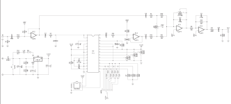

So I'm getting ready to build an Octagon MultiFX pedal and wanted to do some pre-planning. I have never built a Reverb pedal before and never worked with FV-1 tech so, as usual, I'm out of my depth here. But I'd like to build it stock and still leave the option open to easily mod it here and there to tweak some of the tones. Can anyone give recommendations for where it would make sense to solder in sockets during the initial build?
Like I said, I've never built a Reverb pedal before so not really aware of the possible mods. I just like to tinker.

I am not sure FV-1 circuits can easily be modified : It is built around an algorythm if I am not mistaking. You could write your own algorythm and reprogram the octagon chip...other than that i don't see what you can do.
Some people have modded them to have two EEPROMs. Both those mods are a lot more complex.
2 EEPROM ? why, what does it do to the circuit ?
A simple mod is to attach pin 13 of the FV1 to ground on a switch to be able to access the FV1 internal patches which I think sound good.
Wait, there is two sets of effects on every EEPROM from pedalpcb ?! Pedalpcb patch and an FV-1 internal/factory patch ? Can this mod work on any FV-1 circuit, like the Unison for exemple ?
The FV-1 has internal patches in it so you can use it without an EEPROM. Pin 13 to ground accesses these patches.
If you have two EEPROM you can choose from more patches - you can still only use one patch at a time.
A simple mod is to attach pin 13 of the FV1 to ground on a switch to be able to access the FV1 internal patches which I think sound good. http://www.spinsemi.com/Products/datasheets/spn1001/FV-1.pdf
Some people have used rotary controls to put the different pots on an effects pedal. Some people have modded them to have two EEPROMs. Both those mods are a lot more complex.

The dual EEPROM PCB I am talking about is based on the mod in this build.
If you have what I think you have, I assume you are talking about a board that allows you to use say a dual op amp as a single opamp. I.e. TL072 to a TL071. That won’t work in this application. Have a look at the drawings in the build report. Hopefully that makes sense.

Yeah, I'm at work and don't recall precisely what I have. It's two 8-pin pads on top and they would go to a single 8-pin pad underneath. It looks like the Arachnid dual op amp mod requires you tie resistors between the EEPROMs. That may be asking too much of this board.
