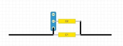

Can someone tell me how to wire the toggle with the caps and board?

JUST TWO SETTINGS:
If you want just bass/treble, use an ON-ON type switch, either SPDT or DPDT.
The DPDT is just like the three-settings one above, you just use the on-on type and omit the cap across lugs 2&5.
For SPDT — Run the cap-in wire from the board to the middle lug. Solder one end of the bass cap to an outer lug, do the same for the treble cap to the remaining lug. Solder the floating ends of the caps together and run a wire from them back to the board's Cap-out pad.
For a board already populated, you need only attach the bass-cap to the SPDT.
A picture is worth more than a 1,000 words of my gibberish!
Yes, same-same as what I described, as what Music6000 posted — just drawn from a different angle. Not a different method, but same method.
