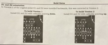

I received my board last month so it’s the new version. Build notes talk about D1 & 2 orientation for building a v1 or v2. I don’t understand why anyone would build a v1. What am I missing?
Thanks!
Kenny
The V1 was how an actual EQD Life Pedal had the diodes oriented. So if you want to Play Authentic (Copyright Gibson 2019) build V1. If you want to build it logically, build V2.
Thanks for the reply Nostradoomus. It doesn’t seem like it would even work in v1 unless you had some incredibly leaky germs!
- Kenny
Guitarists (and pedal folks specifically) are a strange breed, someone is going to insist that the v1 sounds better..... and for them, the info is there. :ROFLMAO:
For what it's worth, there have been mixed results, but I've installed the diodes both directions in three different builds and it sounds virtually identical in all three. A friend has both versions of the original and one clone (with v1 orientated diodes) and says they're indistinguishable.
Wow, that is crazy. I guess I’ll just follow the PCB screen printing and build a v2. I’m a paint by numbers kind of builder anyway!
Thanks - Kenny
Yep. Regardless of why they were originally built the other way, v2 is how they're built now.... and it makes more sense logically.
