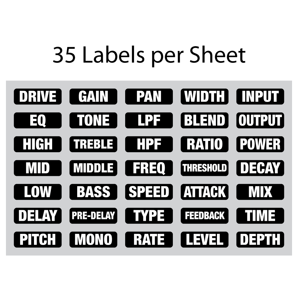

Pedal decals
Some simple pedal stickers for those of us (me) too inept to learn to make them themselves would be way cool
