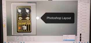

How do you get graphics so opaque? Paper/Ink ? I have big transparency problems on mine... they look ok on pale enclosures, but really bad on darker ones. Ran out of clear ...

Thanks! When you say "2 slides on top of each other" you mean avery over mirror, or two prints on top of mirror foil ?
I'm laser printing, it tends to crack and chip.
Yes, Avery transparent printed foil over mirrow foil. Works perfectly
