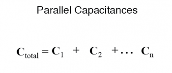

I didn’t have a 25u cap to hand so there are 4 100u caps in parallel.
