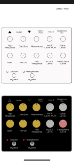

So I’ve seen a few threads about a project like this and I’ve done a bunch of googling for what circuits to use and I’ve settled on building a UniCab into a Gorva S90 with a 4 channel mixer and the MXR Headphone Amp pcbs from GGG.
The concept is guitar comes in and sees cabsim first and is bypassable and then goes into a switch to either send it back out to my Amp or to the mixer and headphone amp.
in addition to the guitar, I’ll have an Aux input for backing tracks and another input to the mixer for the headphone amp.
im reasonably certain this should work I just wonder about a couple things. Should I use isolated jacks for the two mixer inputs and the headphone output? Is there anything I’m not seeing when it comes to combining these circuits that might give me trouble?
ive done a mock up in Vectr to come up with a drill template and file for laser etching as well as mocked up the colors (this will change 20 times before I order knobs).
since I’ll have no need for stomp switches I’m using toggles which allow me to fit all these pcbs in here pretty nicely with off board pots.
links for GGG boards
Mixer - http://www.generalguitargadgets.com/effects-projects/boosters/mini-mixer/
headphone amp - http://www.generalguitargadgets.com/effects-projects/boosters/headphone-amp/
Thanks!
