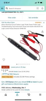

Yep - I second the use of an audio probe.
Do you have a multimeter? When you soldered the ICs straight to the board they could have been overheated. So checking the voltage on the ICs will tell if they have been damaged.
It would also be helpful to have a picture of the solder side of the board.

Gimme just a moment and Ill post a picture
