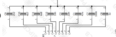

What are you asking? The range finder has a rotary switch that allows you to select the input capacitor to the circuit. This input capacitor is part of a high-pass filter (i.e., a filter that cuts low frequencies). The threshold is adjusted with the capacitor value. A larger capacitor allows more low end in; a smaller capacitor cuts more low end.
The stock value in a rangemaster is 5nF (or 4n7).
Don't worry about the part number of the transistor. There are plenty of Ge transistors that will give you good results. A PNP Ge with a gain (hFE) range of 65–100 with less than ~300uA leakage is fine.

Position 2 (4n7) is the 'stock' position. Keep in mind that it's a rotary switch, so you may have to test it to see which position is actually being connected.
Here is the selection part of the schematic. It shows the switch positions and the associated capacitance.
Hope that helps!

#6 Thanks for the picture
