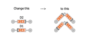

I bought a Dude when they first came out and liked it - except that perhaps it has a little bit more compression than I'd like. So I sold it to a friend. Then a few years later I see PedalPCB had a PCB for it called the Abider. So I built that, then remembered that I'd prefer a little less compression. So I built another one, only this time anywhere it has 2 x 1N4148 diodes as clippers I would add a pair of 1N4001 diodes just as the circuit does in the feedback loop of the last gain stage. So all in all there are three sets of clipping diodes; two in loops and one as hard clippers. In my new pedal all three sets of clipping diodes are a pair of 1N4001s in series with a pair of 1N4148s.
I love it! It has done exactly what I wanted. The compression is much lower and the feel is more natural - for me, anyway. Still a clear, creamy drive, just with a broader dynamic range now. I appreciate that not everyone will want less compression but I do, and this very simple mod has worked perfectly for me.
Yes. I have this thing about using 1N4148s with 1N4001s... I'm sure that if you just used 4 x 1N4148s it would sound the same. The main thing is that using a single pair of diodes is more compressed sounding than if you use two pairs.

So you just soldered the 4148/4001 in series and replaced the 4148's with this set? Turning the D1/D2 & D3/D4 clipping circuits into the same as D5/6/7/8 arrangement?
Where there is a pair of diodes shown on the board I used four. So i soldered in the diodes standing up (the diodes, not me) and connected them in pairs at the top. The board shows the outline of a diode - I install two in that space.

Just want to support this mod from @HamishR !
I wired the 2x 1n4148 pair locations on the PCB to a DPDT on/on switch and one side I used 2x 1n4148 symm for both locations. On the other side I uses the suggested 1n4148/1n4001 symm pairs for both locations on the PCB and that really opens the pedal up and increases the output as well. Great to have the more compressed option and the open sounding option to choose for different guitars for instance.
