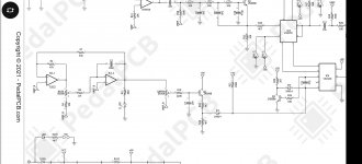

This seems like it's going to be tricky to figure out. Bypass works fine, but the 2nd LED stays lit even in bypass. When I engage the switch, both LEDs light up, but I'm not hearing any of the Chorus effect no matter how much I crank the knobs/pots.
I opted to go with the MN3207 / MN3102 IC pairing, but I suspect that my source for these was bogus (seller on EBay). I've tried 4 out of 10 of the pairs they sold me, and I'm getting the same [lack of] effect with all 4 pairs. I could keep trying out the other pairs, but I'm suspicious that all of them will be the same.
Take a look at these photos and LMK if you see anything else suspicious.
There's a few things to this build that are new to me: not sure what the trim pot is supposed to control, and I've never had to solder an onboard jumper to signify which chip combo I bought. Did I do the right thing by putting a bead of solder to connect each of the 2 sets of pads?
If I dial the trim pot up too high, the sound cuts out. Same if dial it too low. Right in the middle and I get clear sound/tone. What does this trim pot do?

The trimpot controls the Vref value to dial in the sweet-spot for the chorus effect. Its a VERY narrow margin - usually just off center.
Also, did you use the 9.1v Zener diode for D101 withe MN32xx chipset? (If you have the higher value Zener and are using greater than 9v to supply the circuit - it might be problematic. The 9.1v Zener is to protect the MN32xx chipset. The MN30xx chipset can withstand a bit more voltage.)
I'd first ensure that no more than 9V is supplying the circuit, try a fresh set of the MN32xx chips, and try carefully adjusting the trimpot. Be sure to have the Depth pot turned up all the way and the Rate pot at the mid-point. See if adjusting the trimmer while playing an audio signal thru the circuit will dial-in. Use tiny increments.
Question: is your rate LED on 100% of the time, or does it cycle on and off with, blinking faster as you turn up the rate potentiometer?
If it's not cycling on and off, there's a good chance that you'll need to poke around the LFO portion of the circuit, as illustrated here:

Bah, nevermind everyone. I'm completely missing C3 (100nf). I'm going to get my brain examined because this is some really basic shit :)
Ahhh, I see it. Can really only tell from the bottom.
Yup, that'll stop your LFO cold.
