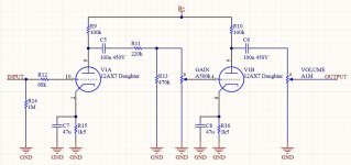

Mmkay, here's the schematics. This is the simplest preamp pedal I make, there really isn't much to it. A quick note, the tube pin numbers will look weird to anyone familiar with tubes as I use a daughter board for the tube, so the pin numbers correspond to the daughter board pinout, not the tube itself.

The tube mounts to a daughter board I designed that also holds the LED. I used to mount it under the tube socket, but it's way harder to service if an LED goes bad so I eventually moved the LED behind the tube. I feed the tube heater in series right off the 9V input; the tube expects 12V in series, but 9V is plenty to get it warmed up enough to pass current. Also saves you a few mA of current on the heater draw. For polarity protection I like to use a schottkey bridge rectifier on the input, so no matter what polarity the input is it will work. I use the schottkeys over standard rectifiers so the voltage drop is negligible.

Not as much of an issue since this is DC (and schottky diodes), but that bridge rectifier offsets your circuits ground potential with respect to the power supply ground. If it weren't for that (or if you had some form of isolation on the DC input) you could power the circuit on either polarity or AC.

Yup, that was something I tested when I first started doing this, and because the difference is on the magnitude of millivolts there isn't any noticeable issue when daisy chained with other pedals.
I mainly started doing it because tube pedals pull a lot more current than typical pedals so I was having customers grab any old power supply to plug in and fry the pedals. Since I don't like saying "you have to use this power supply" this seemed like a quick and easy way to be able to say "use any power supply you want as long as its voltage is less than the input cap (16V) and it has enough current." There was some Australian company that did it on their pedals a few years back, can't remember the name, but I always thought it was a neat idea.
