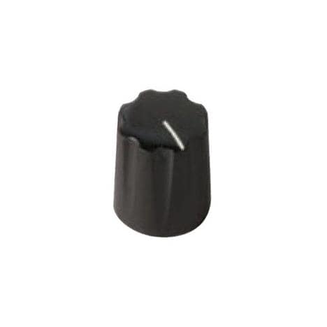

1- I look all over Tayda and couldn't find a pre-drilled 3 knobs in-line box, is that correct... Does it mean drilling it myself is the only way to go ?
2- Knobs spacing, what is the exact distance center to center of the pots ? Looks like 20mm but I'm not sure. I'm considering the Tayda DAVIES 1510 CLONE. They are 19mm at the base, will it fit ?

1. It doesn't look like they have pre-drilled for that config, but you could use their drilling service. I think I've seen a post on here where a bunch of coordinates were posted for several of the PedalPCB pedals.
2. I printed out the drill template and it looks like it's 20mm from center to center. So the 19mm knobs should fit, but if there's any variance in the tolerances of either the drilling or the knobs themselves it might be a tight fit; which could probably be fixed with a bit of filing if need be.
Davies 1510 sound like they'd be pretty crammed together. If you like the look, but want something that easily fits 3-across look at Davies 1611.
The pots on the Spirit Box are spaced 0.8" apart horizontally, the same as the 5 and 6 knob templates.
1510's will fit without any problems as long as your drilling is accurate.
I couldn't find a Davies 1611 on Tayda, KN1611 seems to be similar tho... I did find 1611 elsewhere, but I'd rather put one order in at a single place and other places I found the knobs didn't have great choice for enclosure...
@Feral Feline did you mean Davies 1610 or like @spi motioned the 1611 ?

I just meant the smaller 1510-like version, I don't really know what number they are, just small clones of the 1510.
For example, I'll use clones of the Davies 1510 for volume and gain, and then use the smaller same-style clone for the Bass Mids Treble OR 1900 for Bass Mids Treble. Something like this:
EDIT: Yes, 1611 is what I think of as the small version of the 1510.
