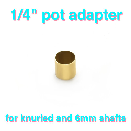

Those sleeves must be made of gold and dodo eggs to justify the price :)
Anybody have any alternatives?
Tynulox 1/4"(6.5mm) OD Brass Tube 0.25mm Wall × 300mm Length × 2Pcs, H62 Brass Tubing Seamless Round Tubing https://a.co/d/ceYLRO4
Just need to find a way to cut to size without collapsing/misshaping the walls at all— I’m thinking the easiest way would be to insert a solid 6mm rod inside to prevent deformation while cutting.
Accounting for blade kerf (using a thin jewelers blade), you should be able to get 45 of them from one rod, for a cost of 27¢ per piece. Could probably find the tubing at your local hardware store much cheaper too— not sure tho since it’s not a super common size in terms of diameter/wall-thickness combination
29 cents at SmallBear. I use a lot of those things, I often superglue in Nomex sheet scraps to fill the split shaft slots. I've used JB Weld in the past as well. Still best practice to line the set screw up with the split when feasible though, IMO.
I can't remember who suggested it, but someone demonstrated that cutting down a plastic straw is an effective replacement for the brass sleeves. Of course, you'd have to find a restaurant whose straws were the right size!

I liked the plastic straw idea, you could even pour epoxy down the straw to cement the bits in place.
