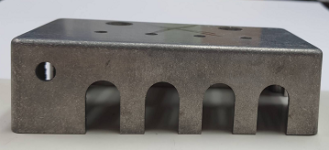

Has anyone used the new Tayda lines/shapes customs drill tool to make slot for linear pot yet? They say minimum hole is 3mm, I’m wondering if that’s their smallest bit? And, will the ends of the slot be rounded according to the bit diameter?
Wondering if I should use the lines tool to make a rectangle of the outline slot I want, or just a single line?
I can ask Hugo as well… just curious if anyone’s gone through it already.
Great info, that answers it for me.
I wonder if they’d let you combine 3mm holes (at the end points) with rectangle to end up with a slot with rounded ends?
Great, thanks!! I already put in an order like this a few days ago based on the confidence I got from yours and Robert's replies!
I haven’t, let us know if it goes through!
To follow up on the thread, I’ve had a few successful projects with the hole/line combo method discussed above
If I put round holes at the end of the lines I don't need to first draw a full rectangle, right?
In other words, 2 holes and 2 horizontal lines are all I need to have a rounded horizontal slot:
