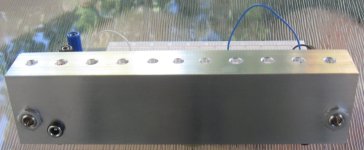

I bought some breadboards on eBay, picked up some scrap aluminum at the local metal yard, did a little cutting and drilling. Voilà! Three more breadboards. The panel has enough holes for eight pots and three toggle switches. The binding posts came with the breadboard and can be used to hook up aux power.

That breadboard setup is super slick, too. Are the aluminum rails glued to the board? Don't see any screws.
Good questions. The bracket is mounted with two #6 screws, nuts & tooth washers. There is enough of a burr around the holes in the black steel plate to ensure electrical contact between the plate & the aluminum bracket.
I rounded the corners on the top. The entire bracket, including the outside edges, was buffed with steel wool. Just enough to barely break the edges.

This bracket was the prototype. I have to pull the jacks to get the pots above them in or out. Not a big deal, but avoidable if I can relocate the jacks.
I used a Makita radial arm saw. I normally use it for carpentry, but that blade is a mean muh-fuh and has no problem with aluminum, just gotta take it slow to avoid galling. I clamped a couple blocks of wood onto the platform to make a jig that kept the aluminum aligned and steady. Set the depth limiter on the blade so it would only cut one wall. Made one pass with the blade, flipped the piece over and made the 2nd cut.
