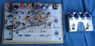

More like this month on the breadboard. I struggled with this one for a while. Dan's demo showed us what a Dr. Robert is supposed to sound like and that provided the guidance I sorely needed. The goal of this mod was to:
  • Ditch the charge pump
  • Have just one stomp switch
  • Bring the BASS, TREBLE & BOOST controls to the front panel
  • Make something that would fit into a 125B box
Here's the breadboard. Once the design has had a chance to mature a little bit, I'll post the schematic. It stayed pretty close to the Vox UL730 & Dr. Robert designs, with a few component tweaks here and there. I adjusted the three tone controls to get a little less interaction. The MIDS scoop is the same, but we lose less treble when MIDS is turned down. I replaced the Mach Schau switch with a Mach Schau knob that lets us sweep the gain of the ouput stage from "Normal Channel" to "Mach Schau" and a little beyond. That knob is essentially the Boost trimmer mounted on the front panel. Most of the work I did was to get the output stage to behave the way I thought it should. I used 2SK193's but any JFET with Vp around -1.0V to -1.5V should work.
Knobs, L-R: VOLUME, MACH SCHAU, TREBLE, MIDS, BASS, GAIN
You can see some candidate JFETs scattered around the bottom of the pic along with three 2N2222As that were kicked to the curb for being too noisy. I eventually installed 2N5089s for Q1-Q3 and the hiss went away. With a 9V rail, there is just as much gain and the output is just as loud as the Dr. Robert.

OK, I'm done! The one on the left sounds like the one on the right. I've concluded that the Dr. Robert is mainly an EQ and a boost. Sure, you can get some dirt in Mach Schau mode, but most of the sweet distortion you hear in Dan's demo comes from Dr. Robert overdriving his amp.

I figured a few things out, thanks to Dan loaning me his Walrus pedal. End-to-end gain and output levels are very similar for both units. The TNK actually goes louder than Dr. Robert, particularly when BOOST is cranked. I took a few parts out, changed several parts and added two parts: TR1 & C40. C40 is silver mica, all the rest are film or aluminum electrolytic. No more charge pump, no more aluminum caps in the signal path. Q1-Q3 can be your favorite NPN Si transistor. 2N2222 can get noisy. MPSA18, 2N5088/89, BC549C or BC550C are good subs. Or go with BC109C if you want the vintage look of a metal can transistor. Use the JFETs of your choice, just shoot for Vp around -1.5V. I adjusted the trimmer to get 4.5V on Q7-S with BOOST at noon. Dr. Robert v1 had two trimmers that are not present in V2. I suspect they did what this trimmer does. Dr. Robert uses 1M resistors for R32 & R33. Those interact with Q6's gate-drain capacitance to roll-off the top end. That capacitance varies a LOT from one JFET to the next, so I installed C40 and reduced R32 & R33 so that the treble roll-off is more predictable. The first stage gain in the Dr. Robert is low, about 9dB, so I left that alone. I cut the gain of the 2nd stage by 6dB so we don't run out of headroom. I cut the gain of the 3rd stage by another 6dB for the same reason. The lost gain is recovered after the output stage because unlike the Dr. Robert, I don't cut the signal down by 11dB between Q7 and the VOLUME control.
I'm not suggesting you do all this stuff to the Dr. Robert; it's a great sounding pedal. This mod is something I did for Cooder because he wanted a modd'ed Dr. Robert design. A big part of the Dr. Robert's marketing is it's sold as a carbon-copy of the Vox UL730 preamp's clean channel. What I did kinda deviates from that, although the differences are subtle and mostly have to do with reducing the tone control interactions. Since the JFET output stage makes the lion's share of the distortion, I think it's entirely possible to replicate the freq response using opamps for the first two stages and let the JFET output stage do the rest.

Hey. I know this is old but are you saying that I should expect no gain on the pharmacist overdrive unless ms is engaged?
I watched Dans video and can hear lots of gain but you are saying that’s his amp and not the pedal?
That is good to hear. I made this recently and have Ben disappointed with gain without the boost. I assumed I had made a mistake. I still might try those mods you suggested another post.
I'm saying that the Clean channel is just that, clean. It has gain, but it's clean gain. The MS channel can be overdriven, depending on how the internal trimmer is set.
When I say "gain," I mean it in the engineering sense. Gain is amplification. Lotta guitar players equate dirt with gain. They are not the same thing. We can have dirt but no gain, or gain but no dirt. Or we can use gain to make dirt. In Dan's demo, he uses the clean channel gain to make his guitar signal big enough to overdrive his tube amp. The pedal and the amp work together to make that sweet distortion, but to be clear, the distortion occurs within the amp, not the pedal.

Thanks for this.
I pulled the pedal out again today as I had shelved it thinking I had made a mistake. There was some issue as outlined in the post here. I managed to solve tho biasing issue by putting a 470k resistor between collector and base of q2.
The pedal sounded quite good today actually and you are right, there is more distortion when played at louder volumes (still haven't had a chance to crank the amp).
Although I still have the sneaking suspicion that it should have more distortion than what I'm getting. Maybe it's just my expectations or maybe there is an unresolved issue.
Before the transistor adjustment mentioned above, I jumpered R13 and R16 and got the sound in the video here with plenty of distortion. However this fix only worked for an hour
I don't have a video of the current sound but it's nothing like the vide above and just a clean sound that is slightly crunchy at louder volumes with gain at max.
