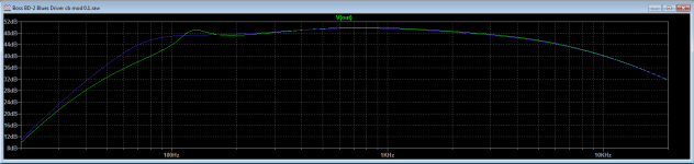

The 10 picture limit prevented me from showing the BD-2's overall freq response. Green: stock; Indigo: mod.
