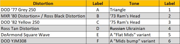

For my first build with the new board, I decided to take a bit of a risk and build a combination I hadn't prototyped yet. Both of my previous builds had been what would now be called a "B3" (see the table below) which combines the MXR Distortion+ from 1980 with a '75 Ram's Head Tone Stack. For this build I decided to go with an A2 - the 1977 Grey 250 combined with a '73 Ram's Head Tone Stack.
