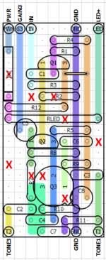

This started out as an investigation into the Apocalypse Audio Mona Lisa Overdrive, but quickly took on a life of its own. The Mona Lisa uses four transistors: a JFET source-follower input, a 2-stage Si transistor amplifier and another JFET source-follower for the output. I hate to waste JFETs, so I replaced the source-follower input with a Darlington emitter follower (Q1). The 3rd stage has a very low output impedance and doesn't need an output buffer, so the source-follower output got tossed overboard. I bumped the max gain up by 6dB and added a TONE control. Works well with Si transistors and gets just a little sweeter with Ge for Q3. The DC feedback loop around Q2 & Q3 keeps Q3's bias stable. This circuit is very flexible when it comes to transistors, just about anything will work. I did not need to adjust any resistors when changing Q3 from Si to Ge.

This thing really surprised me with how good it sounds. It has a tight bottom end, maybe a little too tight. I'm still fiddling with C5. Max gain is a modest 57dB. With single coil pickups, it plays clean when GAIN is at noon. Humbuckers require setting GAIN down around 10:00 for clean playing. Clipping comes on very smoothly as GAIN is advanced. Chords are clear, even with GAIN dimed. There is a nice midrange honk at the higher GAIN settings. I'm definitely going to build this one as an actual pedal, not just a toy on a breadboard.

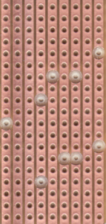

I can see why you added the image of the underside of your vero board. As someone who takes great pride in the drillage of cuts in vero board I applaud your skill. Simply beautiful cuts. I have to agree with jubal81. Hauntingly perfect.
Another Deliverance reference.
But seriously folks, a drill press with an accurate stop and a sharp drill bit is all it takes. Once I had the stop set, I drilled 9 holes in about 15 sec. I used to cut Vero holes by hand with a pin vise. Then I was lucky to cut one hole per minute.
Thanks, Hamish, I wasn't trying to show off. I posted that pic in case anyone wanted to know where to make the cuts.
Well I was being facetious and admiring at the same time. I didn't think you were trying to show off. Actually I thought it was a good idea to show what the board looks like at various stages. It's something we should probably do more of for those who are new to this.
