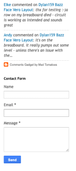

You may want to ask Andy over at Vero-P2P as he posts a lot of 0.15" pitch vero layouts. The contact form is at the bottom-right of the sidebar:
