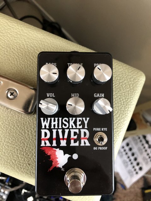

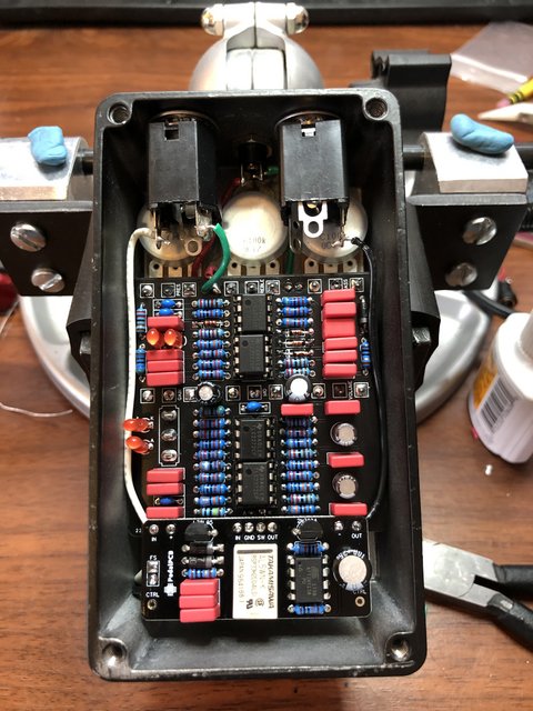

Mentioned in another thread, but this is my favorite MIAB among all I've ever built. Sounds every bit as good as the demos.
Only substitute I made was using TLC2272 because I didn't have any 072s on hand. Sounded so good, I just left them in there. Just have to remember not to plug in 18V because the 2272s are 16V max. They're also rail-to-rail.
Cool Build!
