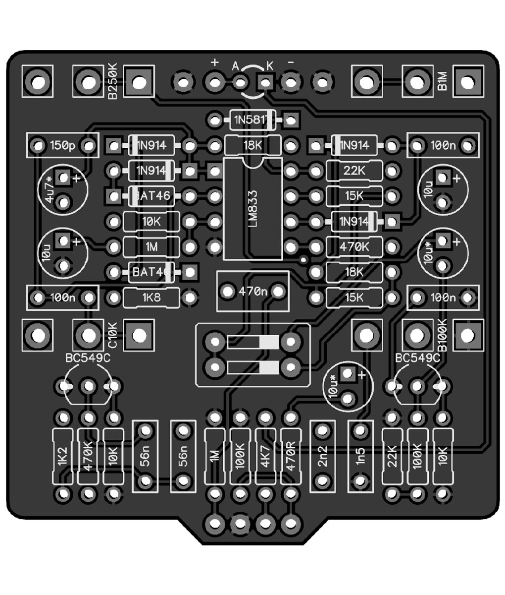

Xotic Soul Driven
HamishR
Interesting - according to Aion it's basically a modified Blues Driver. I don't mind that - I like pedals with more EQ, especially control over the low end. A Blues Driver with control over mids and bass sounds alright to me!
phi1
FWIW... Modified blues driver is not how I would characterize it after reading his article. the back section of the circuit is basically from a blues driver, the part with the 120hz hump that is adjustable via the dip switches.
But the rest of the circuit structure (gain stage, pre-dirt eq, post dirt treble cut) is much more similar to a zendrive, or other op amp ODs with feedback loop clippers like the Timmy. So it’s more of a hybrid taking ideas from different circuits.
Just hoping to avoid confusion/ jumping to conclusions if anyone reads this thread without checking out the aion article.
HamishR
I must have misunderstood. Still, at least now I know how I can add a bass pot rather than use just the switches. :)
