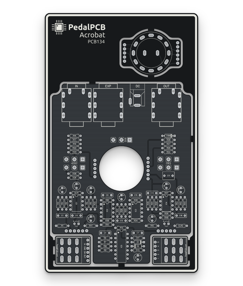

Would these work as well for all 3 jacks?These are the type I used for the prototypes:
I'm planning to work up an alternate Tayda drill template with slotted holes for the jacks so these can also be used, but you'd need the holes slotted to the edge of the enclosure in order to use them.
6.35mm 1/4" Stereo Insulated Unswitched Socket Jack PCB Pin
Get It Fast - Same Day Shippingwww.taydaelectronics.com
Thanks. While I have you, what are the FCR14422 used for? Is it for the jacks?That looks similar, both are clones of the Neutrik NMJ6HCD2.
Also, you might want to drill a slightly oversized hole for the expression jack. It needs to be insulated from the enclosure.
Ooh so that's what those holes are on the PCB on the ends of jacks??Yep, they're for grounding the enclosure.
You really only need one, either on the input or output jack, or you can ground it by some other method.
Sorry, one last thing (maybe), for the rotary pot daughterboard, is it meant to mount to the PCB with pin headers? I haven't used those yet...Yep.
